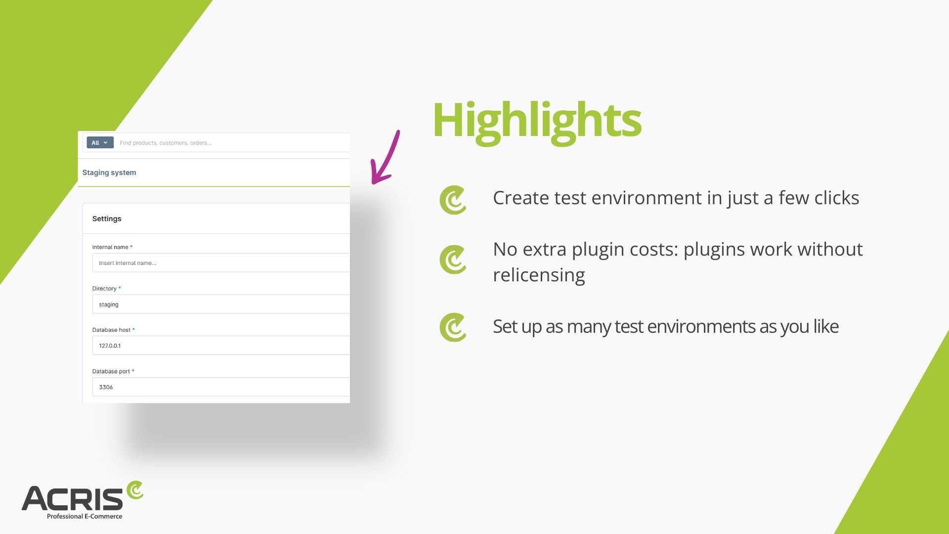

  • Create test environment in just a few clicks
  • No extra plugin costs: plugins work without relicensing
  • Set up as many test environments as you like

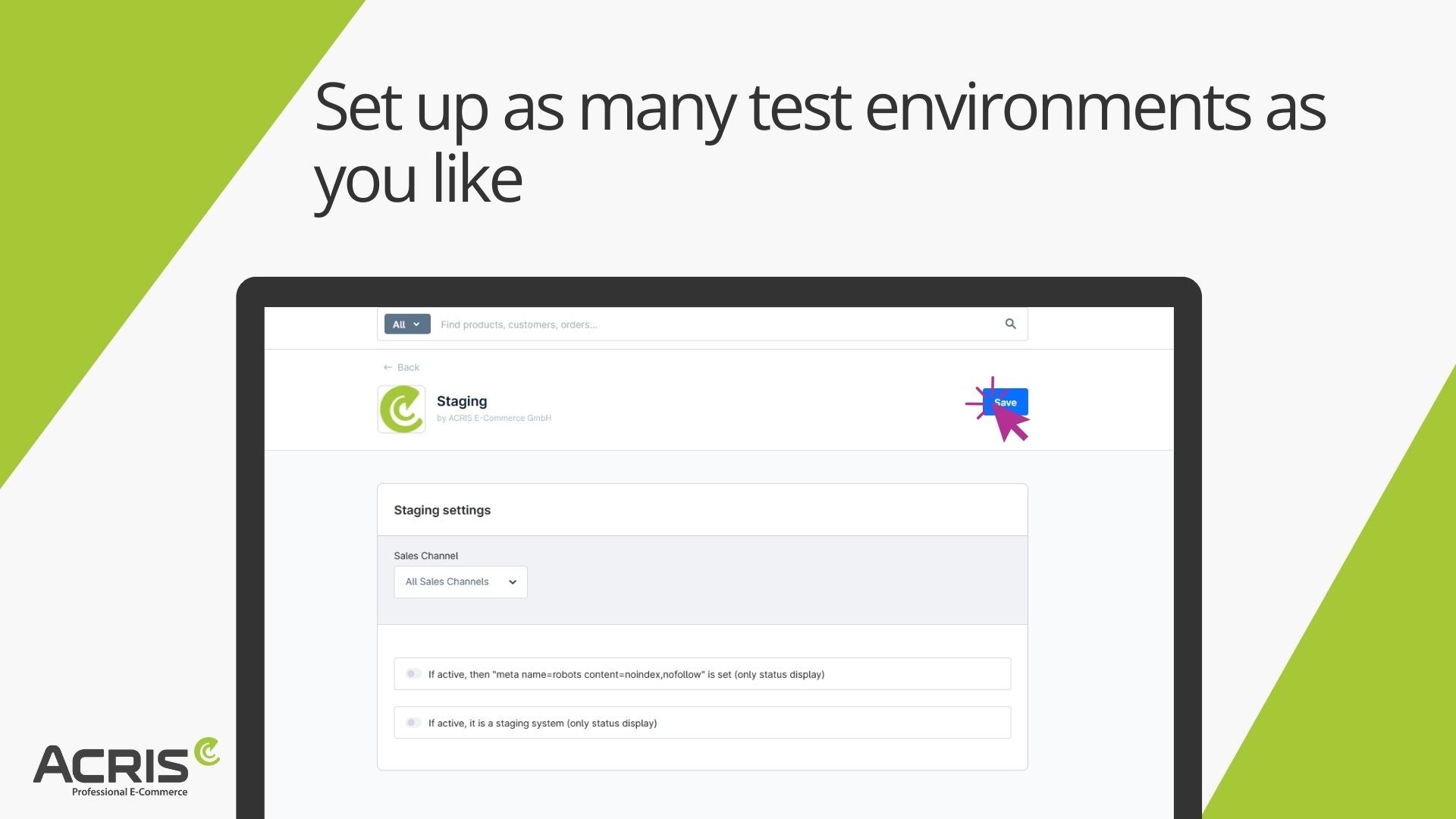

  • Easy setup: create a test environment with a few clicks
  • DSGVO compliant, as customer data and orders are only copied on request.
  • Easy copying or deleting of test environment (file structure and database)

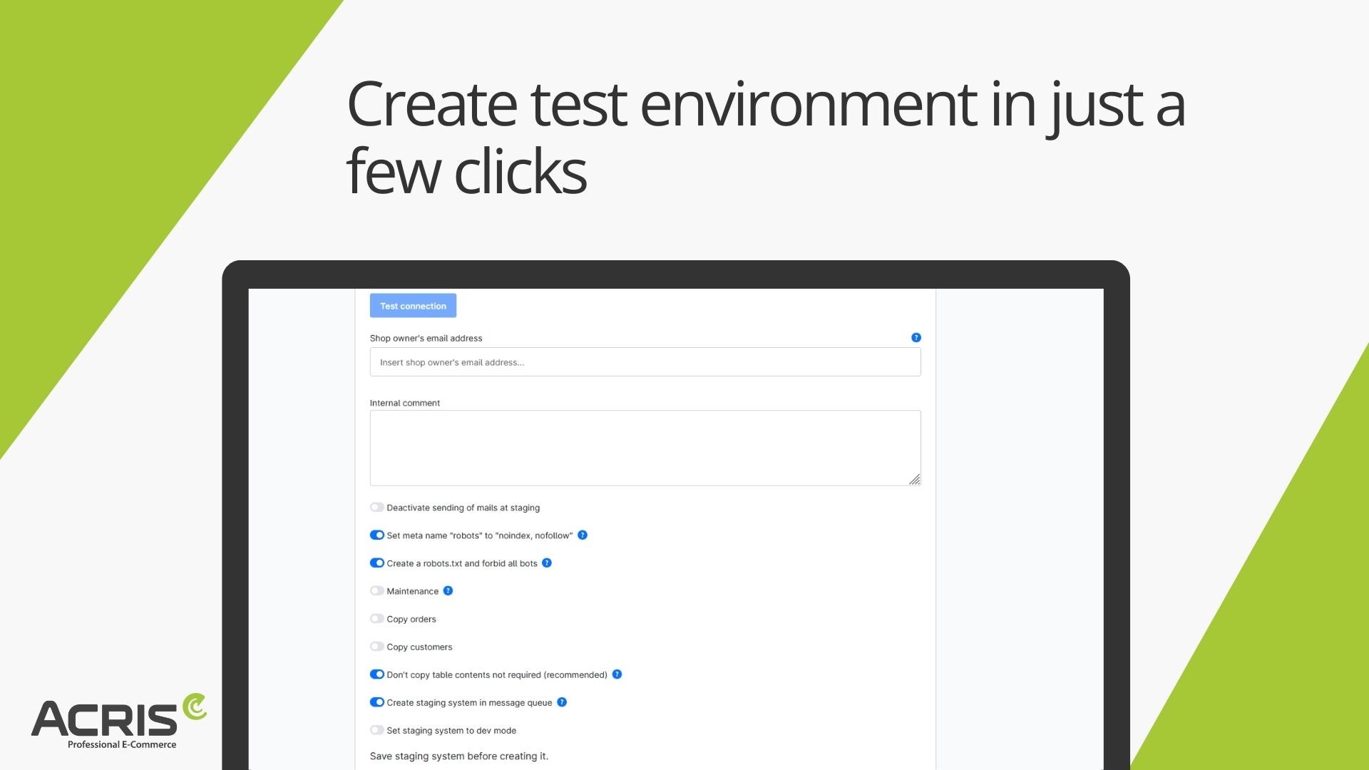

In the Shopware Admin area under Settings -> Plugins -> Staging-System has been added. In the first step please "add" a new staging-system.
  • Internal name: is only used for the overview if you create multiple staging / test systems.
  • Directory: into this directory (e.g. staging) the complete Shopware 6 system will be copied and can be accessed after creation in the frontend under www.Domain.com/staging or admin area www.Domain.com/staging/admin
  • Database host: if the database is located on the same server as the Shopware system's website, use the default value; if not, use the host from the database server. Default value: "localhost".
  • Database name: enter the name for the test environment database
  • Database user: enter the user for the test environment database
  • Database password: enter the password for the test environment database
  • Shop owner e-mail address: If a different shop owner e-mail address is to be used for the test system than in the live system. Otherwise leave it empty.
  • Maintenance mode: If this is activated, the test system will be put into maintenance mode after the test environment has been created.
  • Copy orders: for DSGVO reasons the orders should not be copied for test systems, but this is possible with set hacking.
  • Copy customers: for DSGVO reasons the customers should not be copied for test systems, but this is possible with set hacking.
Before the actual copying takes place, please save the configuration and then the button "Create Staging System" is active.
