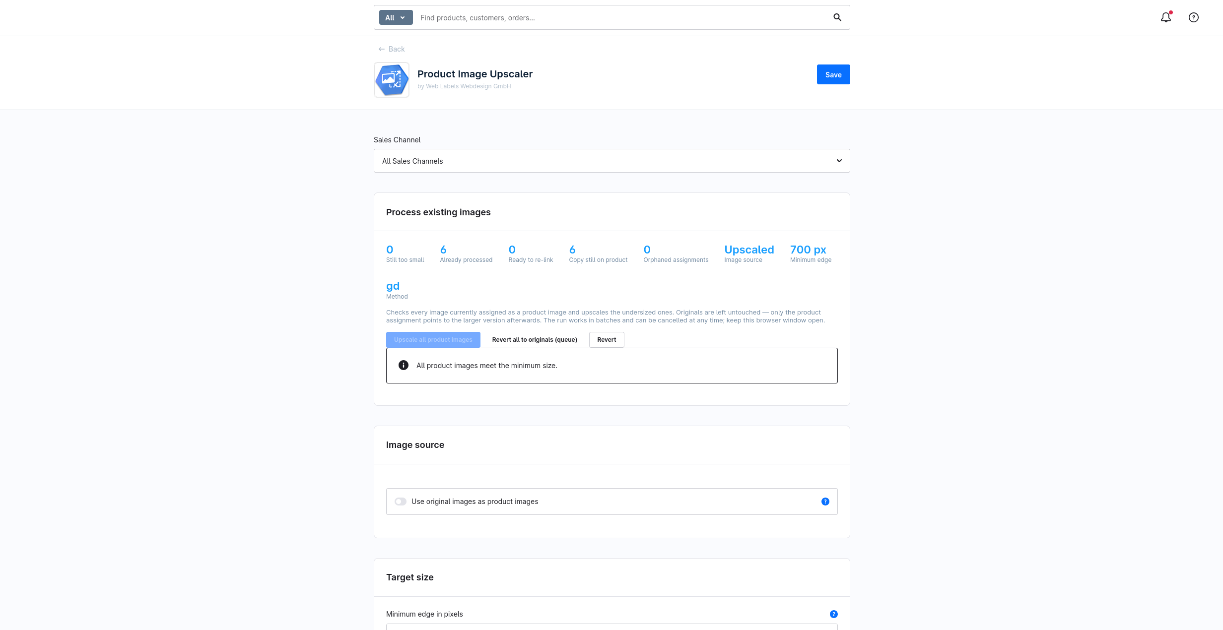

Process existing images
Shows the current state: images that are still too small, images already processed, the active method. Depending on the situation, it offers the matching actions:
- Upscale all product images – Processes all undersized product images in blocks. The run can be cancelled at any time.
- Add to queue – As above, but in the background via the worker. The window doesn't need to stay open.
- Refresh to new minimum edge – Appears after you've raised the minimum edge. Re-renders the affected copies from the unchanged original.
- Re-link existing images – Links copies that already exist back to the products, without recalculating them.
- Revert – Switches the products back to the originals. The copies are kept.
- Reset orphaned images – For special cases, such as after a database migration: copies without a stored mapping are matched to their original by file name. Use "Show preview" first to see what will happen.

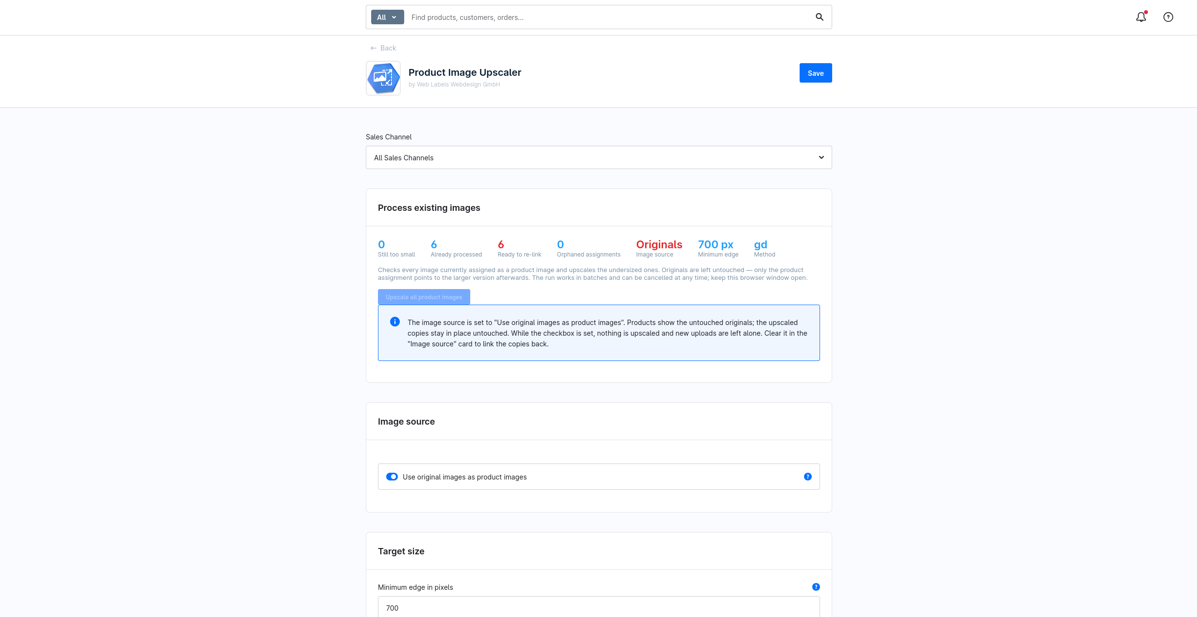

Image source
Use original images as product images (default: off)
On save, switches every product back to its original image. Nothing is deleted: clear the checkbox and the copies are linked again. While it's set, the plugin leaves new uploads alone.

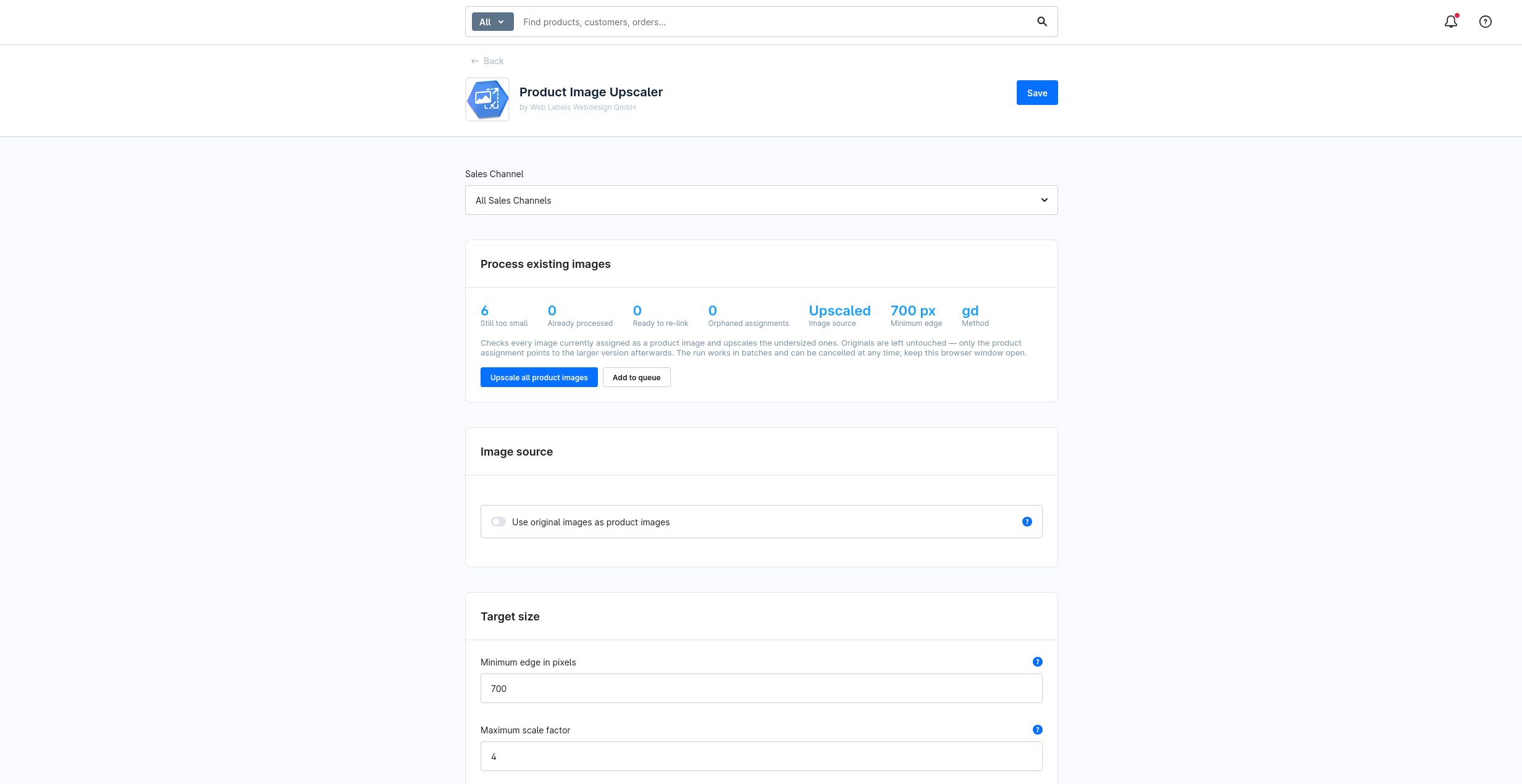

Target size
Minimum edge in pixels (default: 500)
Images are enlarged so that the shorter edge reaches this value. The aspect ratio is kept: 400 × 365 becomes 548 × 500, not 500 × 500.
